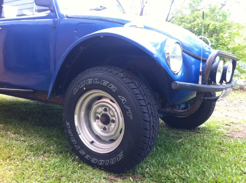

It was fine when i left home, drove a couple of kms to drop off my youngest son, then when i went to get back in the car, the r/h front tyre was half flat, no worries I thought, I'd drive to work an get the puncture repaired....... No such luck, got about another km, and the tyre was completely flat......... There was a slash through the tyre on the inside sidewall..... finished the walk to work, and found out I'd need two tyres as the ones on it havent been made in about 10 years. So now I've gone from a 215/80R15 to a 215/75R15
Should last another 10 years now :D

They look fine! I havent seen 215/80R15's for quite some time, mind you I havent looked either. Better test them out on the beach I say to be sure !

Ive got the same tyre in a 32inch on our Prado, and they went fine on our trip to Fraser

What size rims are those? (width)

Postby VWNuts » Sat Dec 10, 2011 10:54 am
6 or 7 I can't remember

ive got the 215/80/r15 on the front of my baja now that i looked

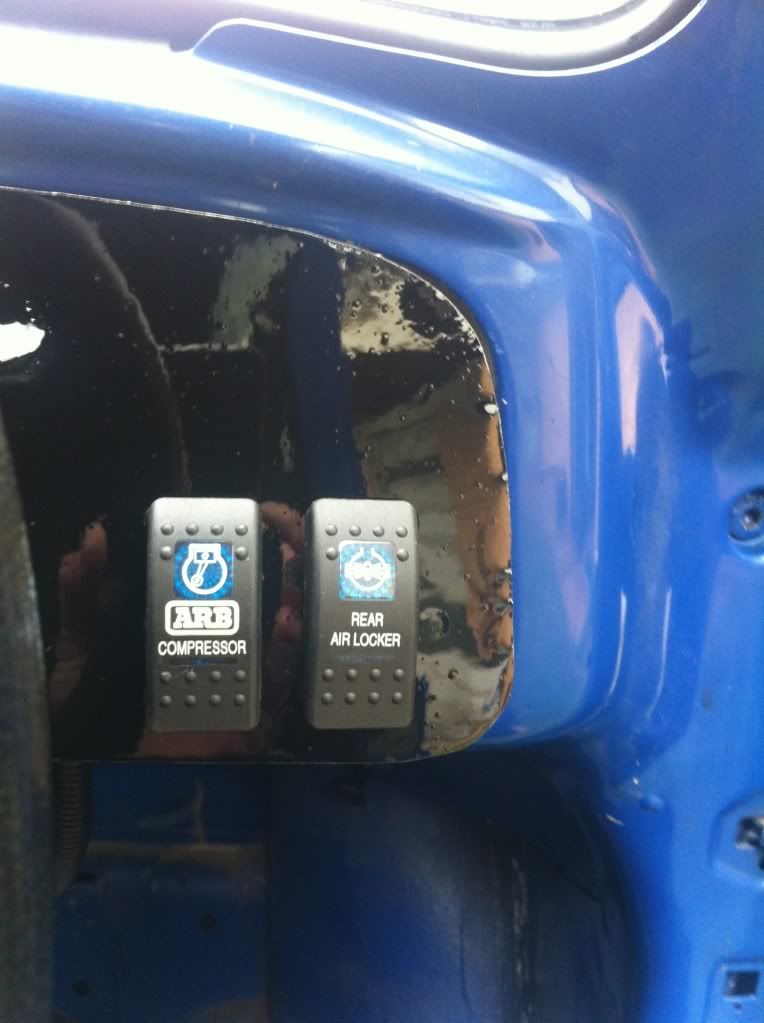

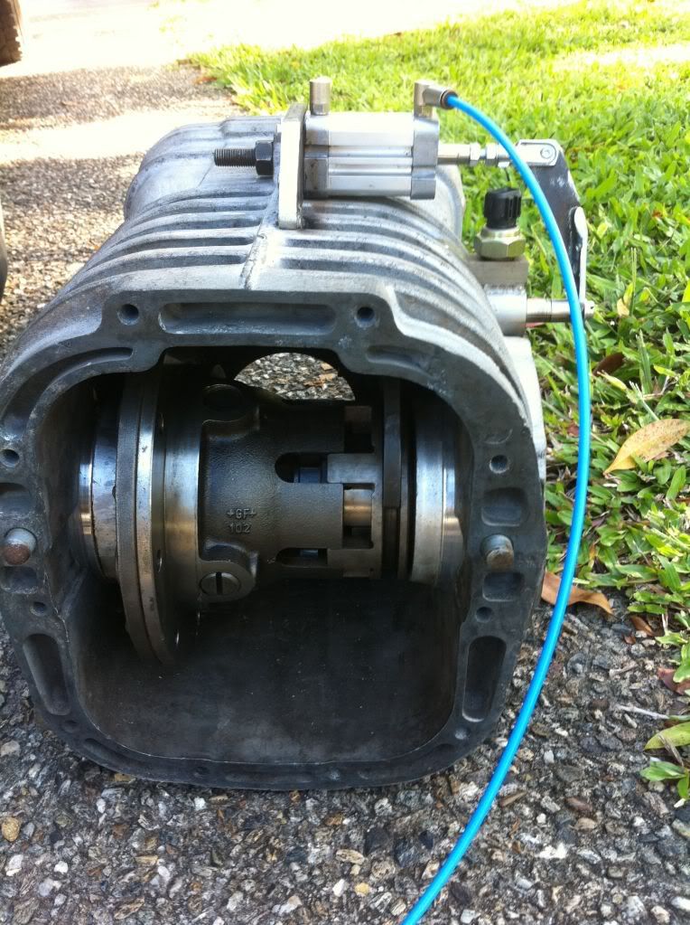

Well now that Paul has installed a Locker diff into his Budget Baja Bug, I guess I'll be needing this to keep up.......

Postby BlueV2 » Fri Dec 23, 2011 10:59 am
Are they just stickers :!: :D
Re: Josh's 68 Baja Bug
Postby VWNuts » Fri Dec 23, 2011 2:46 pm
Nope, one operates the air compressor, the other operates the diff lock, thought that was self explanatory....... :P
Postby manxiberty » Sat Dec 24, 2011 7:08 am
Sik.... so i wont be the only one sitting at the top of hills :)
Postby VWNuts » Mon Dec 26, 2011 4:18 pm
Well now that the Xmas festivities are out of the way, its time to get back into the cool stuff.

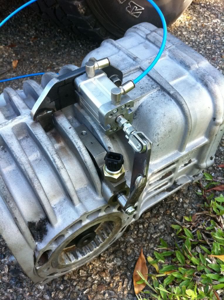

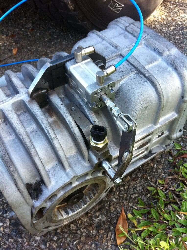

Now Paul has made his difflock very simple..... one cable and its on. That seemed way to easy for me, so I've got, an air compressor, air lines, air solenoid, air actuator, pressure switch, wiring loom, control switches, air tank..... you get the idea, BUT, all that stuff means I flick one switch to turn on the compressor to fill the small tank, then whenever i need to have the diff lock activated, i just flick the diff lock switch on the dash just like the 4wd's do and im locked in :mrgreen:
Here is the diff unlocked
And after a flick of the switch on the dash, here is the diff locked
