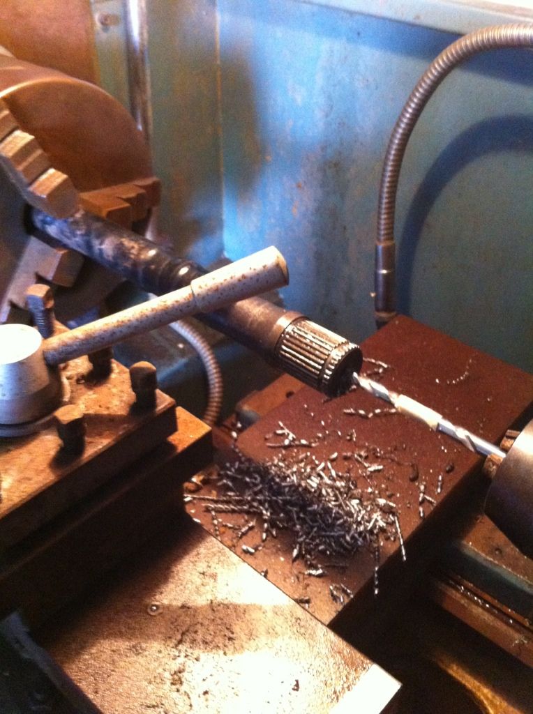

Drilling the axle in the lathe

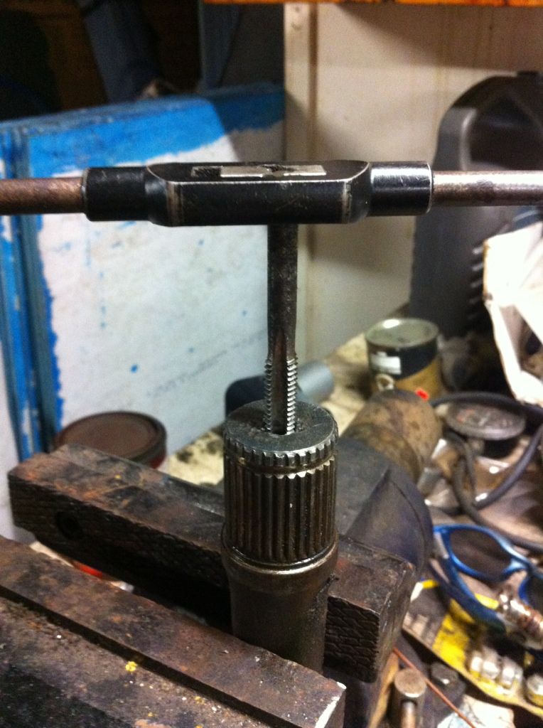

Tapping the 8x1.25 thread for the locating bolts that eliminate the circlips
