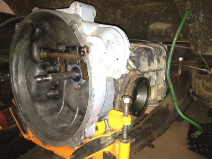

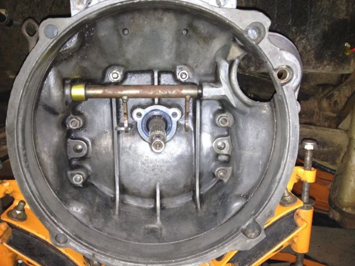

Well today I had a play with one of my 002 3 rib boxes. Plan is to suss out how to remove the big bearing. I thought I might change the bearing in my current box as its very noisy and also had a thrust plate, grease the shift ball plus replace seals while I'm there hopefully this will help.
Heres a few pic's of the old box
Anyone know how this diff comes out?
I am trying to split the rear case but there must be a few more circlips somewhere,
Re: Blue and Orange Manx
Postby VWNuts » Tue Mar 26, 2013 5:30 am
That bearing you want to replace is the mainshaft bearing, which requires complete disassembly of the transmission, and needs special tools to do so

Gearbox was pretty bad, ended up getting the diff side plates off, pull the diff out and inspected the pinon. It did not look good at all.
I picked up another box off gumtree and cleaned it up and wacked it in. Its been running good so far. time wil tell :lol:

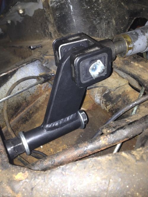

A couple of new seals installed,
Getting it strapped down,

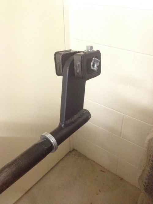

While I was at it, also had a new adjustable shift rod extension made up by Paul at Steel Art. Top job :D
All installed

Postby PUD » Tue Dec 03, 2013 7:04 am
Like that idea for the shift rod extension, might have to talk to Paul about that one, mine is pretty much a solid connection & I dont recon it'd be durable enough for the long haul :)
Postby josh702 » Thu Dec 05, 2013 10:31 pm
It's Definitely worth looking at, and having abit of adjustment there is good too :)
