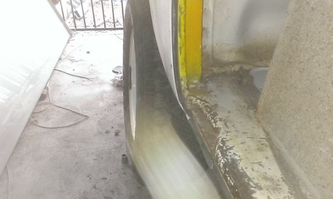

may have to run 15'' rims these are going to hit the guard
plenty of lift
