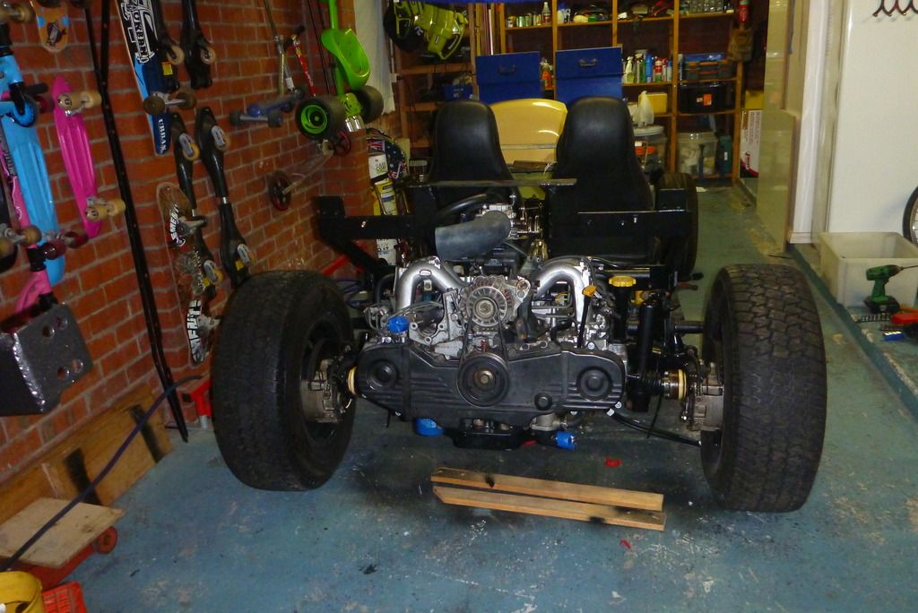

And put the wheels on :D
Yes, its a roller 8)

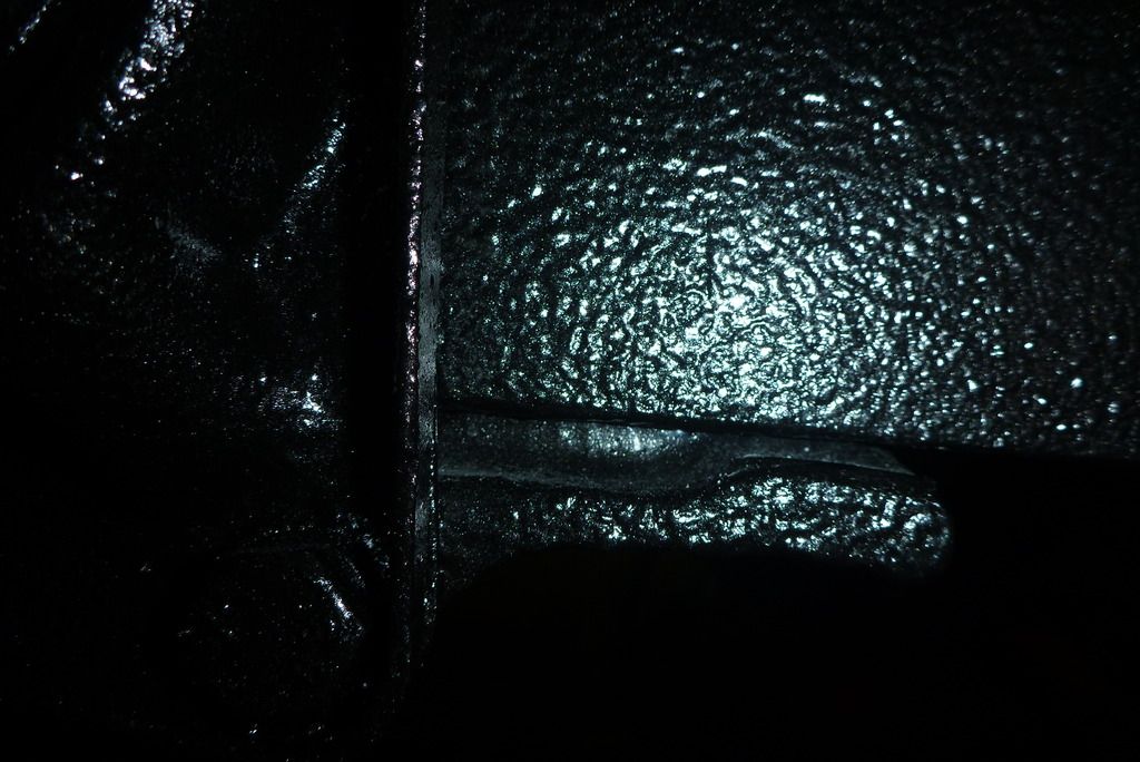

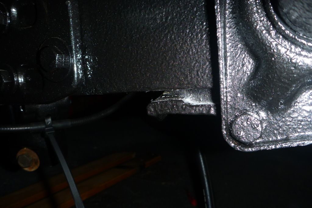

I put heavy duty torsion bars in and have the adjusters wound right out and get this on the right.
An this on the left.
There is a bit of weight to go on yet but is this enough off the bottom or should I pull it all off and go down one spline???
How far are they supposed to be up at rest???

Postby Vduboy » Tue Aug 25, 2015 8:37 pm
I would leave that until you get the rest of the weight on there mate. You still have a heap to put on it. You probably want about 1/3 travel used with all your buggies weight on there.
Just so you have some droop left over too.
