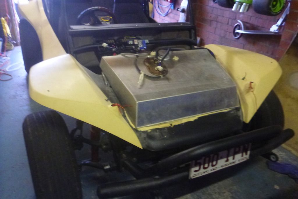

Buggy is back in the shed and ready for the final push to finish for Christmas. One issue I found AFTER cutting the alloy tank - cut on the left side looking at it- is the pump seems to be upside down to fit (fuel lines point up) and the fuel gauge bit has no hope as it hard up against the rear of the tank.... So my question is, have I cut it on the wrong side, how do I get the fuel gauge float to fit, are there aftermarket floats and how do they fit? Soooo bummed, what are my options from here :?

Wondering if you got things sorted Geoff, I guess the worst scenario would be if your cut-outs are wrong'd be to get a patch plate tigged in & start again?? Is it the subi pump & sender unit you're using?

Did it this way - put a small bracket to relocate 90degs and out about 50mm. Fits now :D Just have to see if it works :wink:

It fits and seems to work :D well the gauge shows what I expect to be in the tank

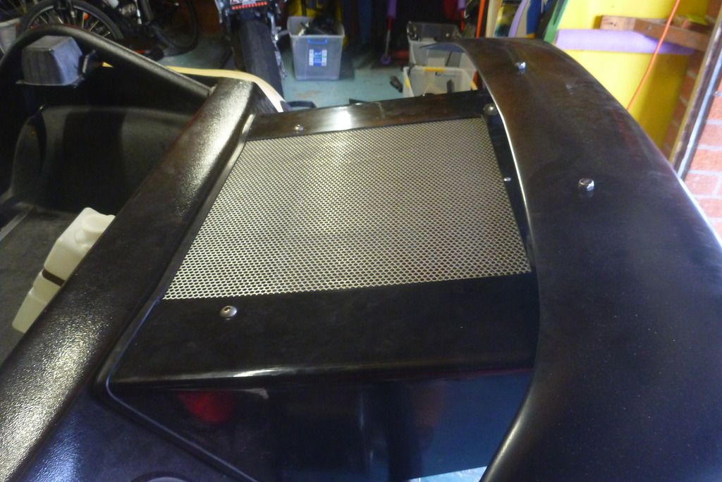

Fitted up the rear wing/radiator set up. The wing stand off pieces are air con risers and work pretty good I reckon.
Put some perforated ally sheet over it all and viola. 8)

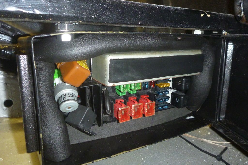

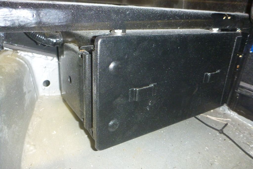

Fitted up the 50 cal ammo box under the seat for the fuses and ecu - out of the way and watertight

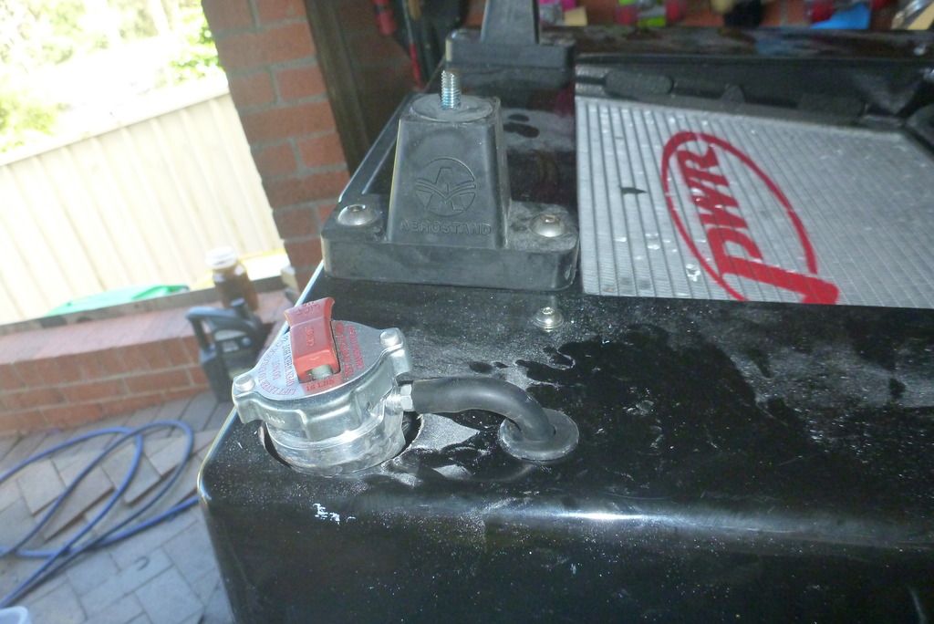

Also have oil coming out of the Subarugears oil breather, not sure what is going there but it is up high and full length of tube with gearbox only full to visual level 1/3 up on the sight glass

engine stalling > check your idle air control valve, make sure all your breathers are connected, fuel pressure and you have got your high pressure hose on the correct port ie and the return to tank comes off the reg, does your fuel pump run in the test cycle as with your thermofans? ? ( two green connectors with your test plug?) are you getting an engine fault if so plug the black connectors into each other then count the blinking lights to see what number fault you have...
where is the breather on the subarugears box? will have a look at joshes as it was in the same batch so should be similar...
