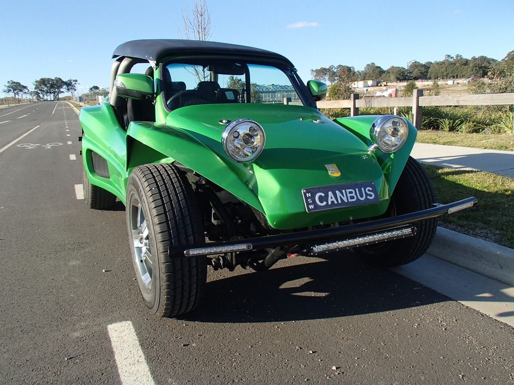

Postby toddy101 » Sat Aug 13, 2016 10:32 pm
Ooops, been a while since I posted an update. Been flat out mad with work and trying to finish the car to get it to Valla I had no time to muck around on the forums. I ended up getting the engineers certificate the Tuesday of the Valla week, Blue slip and rego sorted on Wednesday and then took it to Valla on the Thursday. Theres still 100s of little things to finish and sort out but the main things are done and it is on the road.
Quite happy with it so far, it drives well. The performance of the 2ltre FA turbo engine has me blown away, it is nothing like the EJ20T of my old buggy. the twinscroll turbo boosts up super quick and down low in the rpm, there is just no lag. Gets up to 1.4bar (20psi) by 3500rpm. I'm still waiting to get it tuned, so not going too crazy with the revs just yet.
Its just good there was no real issues or show stoppers at the end, a few things were untried, particularly the brakes. I used the Subaru Master cylinder and brake booster, stock beetle front brakes, and subabrakes rears. I had to put a valve in to wind down the rear braking just a tiny bit and the result is brakes that feel like a modern day car, nice feel to the pedal and stops well. The handbrake is the best feeling handbrake ever, better than the falcon and sherman brakes i've used in the past.
Done a few hundred km in it now and its using about 8L/100km which is fantastic considering its been relatively short trips around town and not much highway/freeway driving.
I got a video as well which is uploading so will post that tomorrow.
Sharpbuilt Limo with EJ20T Subaru turbo.

Postby josh702 » Sun Aug 14, 2016 10:16 am
Cool build, theres some pretty tricked out gear on it. Has the rear roof support system been modified to clear the Subaru seats?
toddy101
Posts: 143
Location: Newcastle
Re: Canbus Manxster Project
Postby toddy101 » Mon Aug 15, 2016 9:22 pm
Yes, I had to raise the height for the headspace according to my Engineer.
